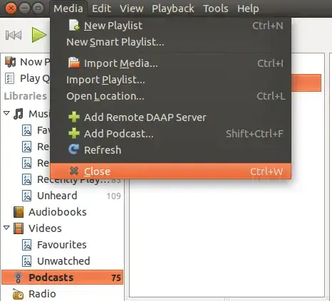

Note - you need to pause whatever is playing first otherwise all of the following methods will only close the window but Banshee will remain running in the sound indicator.
Click Media -> Close (Media -> Quit for Ubuntu < 11.04):
banshee close
or
press Ctrl+W
or
press Alt+M+C (Alt+M+Q for Ubuntu < 11.04)
or
right click on the launcher item and click 'Quit':
banshee quit launcher
