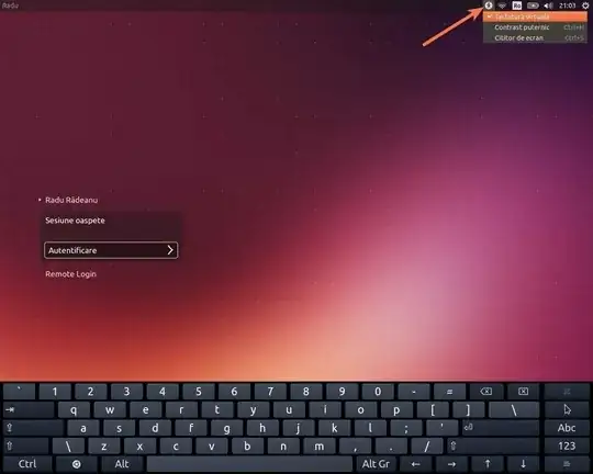

Now save the file and close the editor. To test it, just log out. You'll be back at the login screen. Click the Universal Access icon (the little man), then On Screen Keyboard. If everything's set up right, onboard should now appear on your screen.
Where to find the On Screen Keyboard option
Onboard is activated

Just click on Virtual Keyboard in the Universal Access indicator from the top-right of your screen:
Virtual Keyboard
