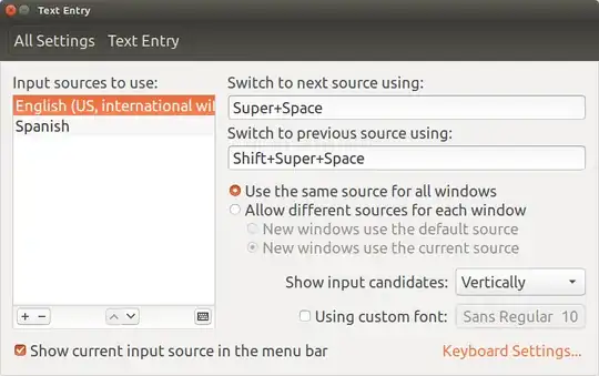

A. Ubuntu 14.04, 16.04 (Unity-based):
Click the Unity Search button (Ubuntu logo) and type in "Text Entry".
Click the little + button and add a new keyboard called "English (US, international with dead keys)". It will now look like this:

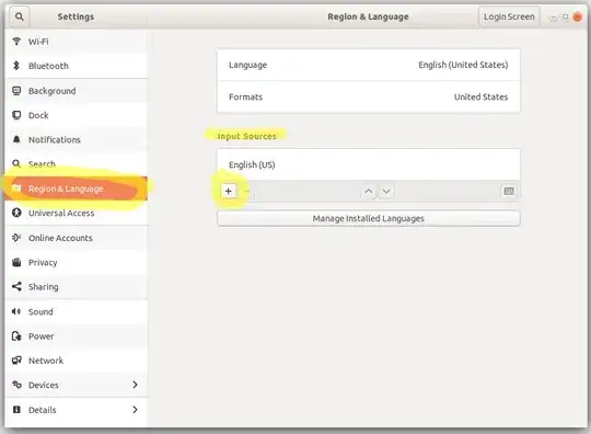

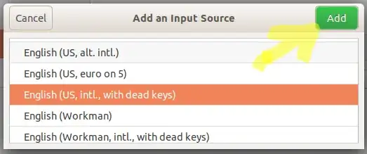

B. Ubuntu 18.04 (Gnome-based):
Go to Settings --> Region & Language --> click the "+" button under "Input Sources", as shown here: enter image description here Next, in the window that pops up --> click "English (United States)" --> "English (US, intl., with dead keys)" (as shown below) --> click "Add". enter image description here
NOW REBOOT YOUR COMPUTER! If you don't reboot now to finalize this change, the special accents and key sequences described below may not work.
2. How to Use:
Click this little button in the top right of your desktop task bar to select your keyboard now:
enter image description here OR enter image description here
OR use these keyboard shortcuts to change keyboards:
  1. Windows Key + Space bar = next source
  2. Shift + Windows Key + Space bar = previous source
(You'll see the little number in the bottom right of the image above change when you do this to indicate which keyboard is selected).
