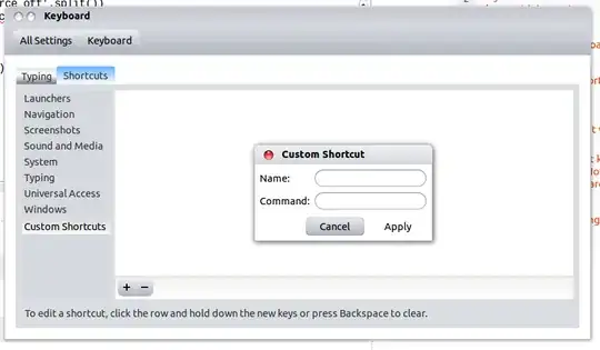

I want to add a Custom Shortcut (Keyboard → Custom Shortcuts → Add) for turning off the display but to do that, what 'Command' should I should use?
I want to set a button to switch off the display and switch on.

Then open your unity dash and type as keyboard and open it.
after opening it click at + symbol to add it.
Then in the name field type name as monitor off & at command field type path of the script. In my case it is ~/monitoroff.sh

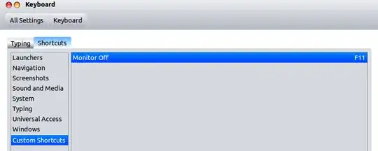

after adding it click ok.
then select it with mouse and then press your hotkey , in my case it is F11.
to power on your mouse again click your mouse or press escape key .
Then enter image description here
