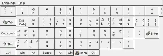

In general, where the picture below shows two columns of characters on the same key, the bottom row of the left column is entered by THAT KEY itself. The bottom row of the right column is typed by Alt Gr+THAT KEY. While Shift types the upper row characters.
Thus, Alt Gr+O results in ओ and Shift+Alt Gr+O results in औ.

The full Bolnagri kekboard layout is:
