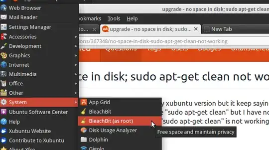

If you want to clean more space , you can use bleachbit,:)
you can install it with sudo apt-get install bleachbit and also from software-center.
after installing it , you can launch it from System -> Bleachbit(root) . so that you can clear maximum of useless data.
