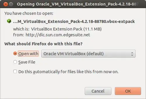

Check that the version of Virtualbox you have. Mine is 4.2.18 and double click the link
You should see something like this
Click OK and let it install.

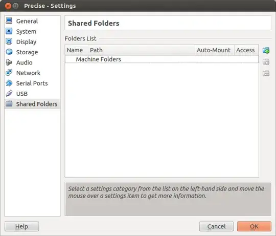

First, make sure that your virtual machine is powered off.
machine-state-powered-off-image

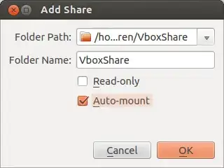

Then, go into settings for your virtual machine, select shared folders then the plus icon to create a shared folder and fill in the details set it to auto mount.
Click OK then start your guest.

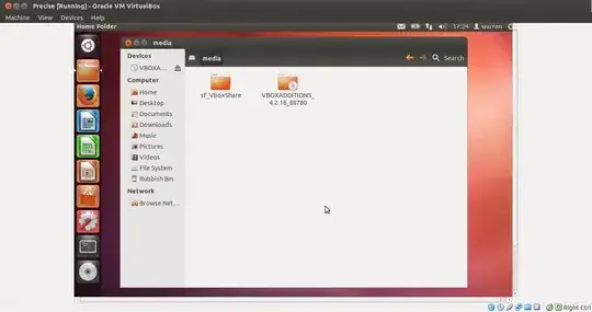

Job Done the shared folder appears on you guest machine as
/media/sf_Vboxshare
There is only one more step add any user in your guest system that needs access to the folder to the group vboxsf:
sudo adduser $USER vboxsf
Log out and back in, everything should work fine now.

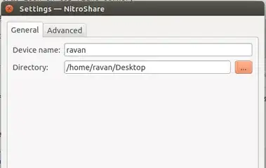

  3. By default the destination folder is ~/Desktop. You can modify it in settings.
