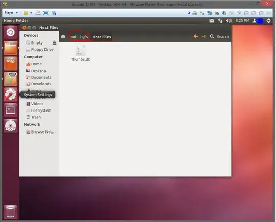

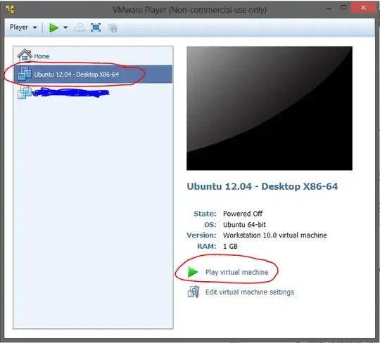

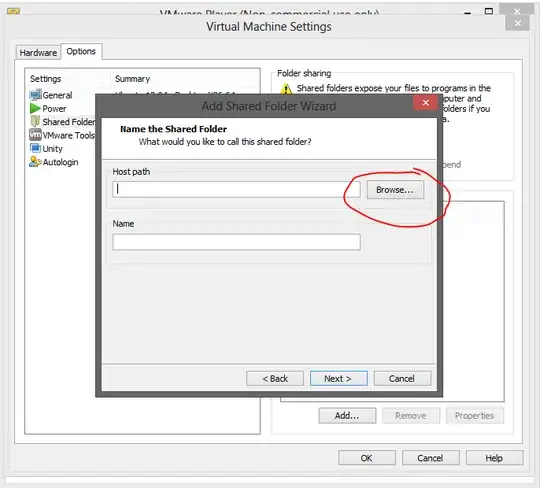

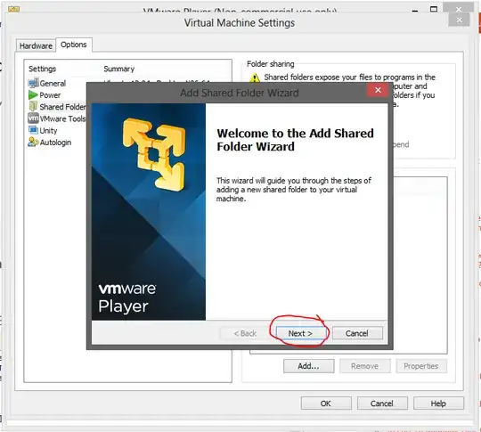

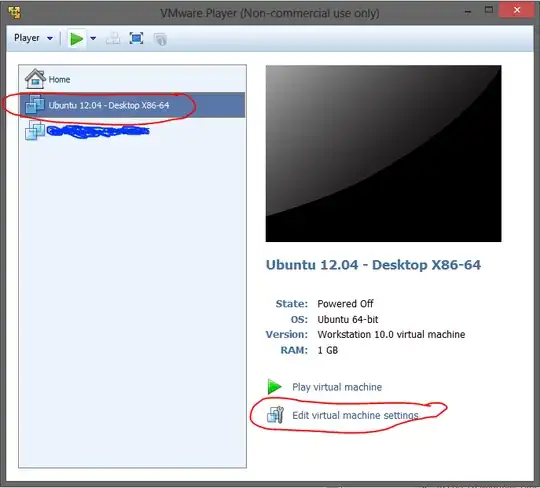

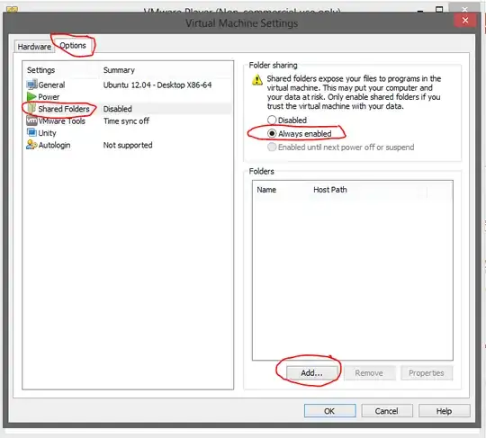

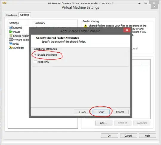

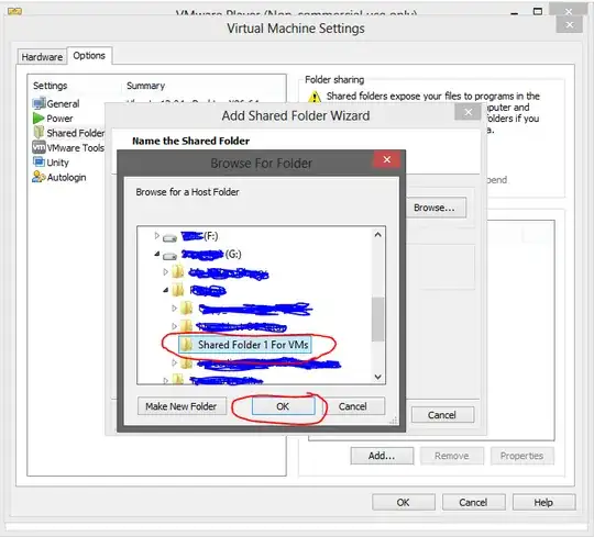

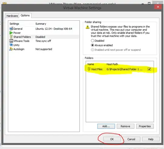

How to enable a shared folder in VMware Player:
[Windows 8 - Core X86-64 host][Ubuntu 12.04 - Desktop X86-64 guest]
Step #1
Step #2
Step #3
Step #4
Step #5
Step #6
Step #7
Step #8
Step #9
Step #10

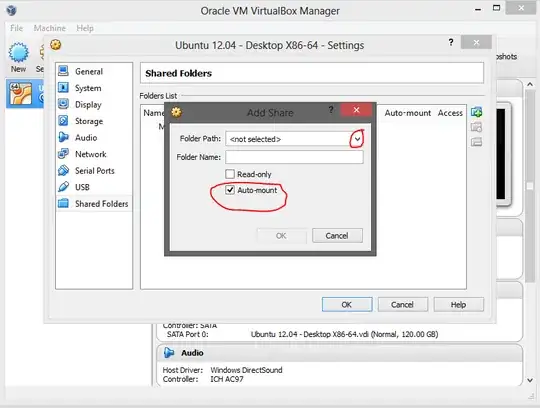

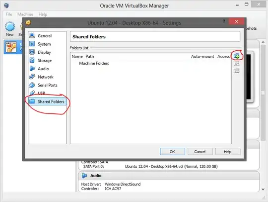

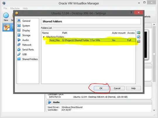

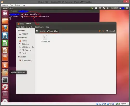

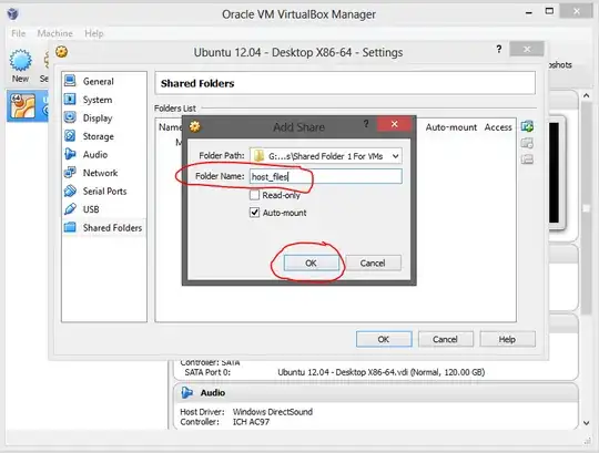

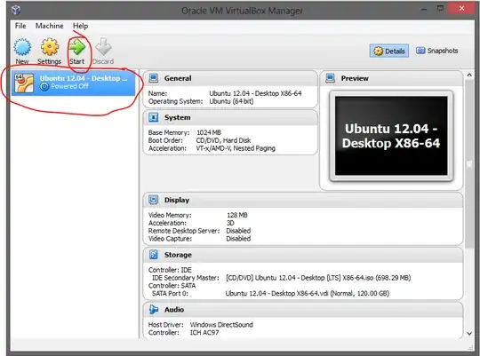

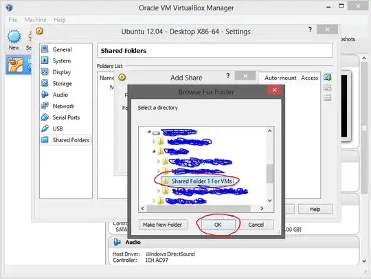

How to enable a shared folder in Virtual Box:
[Guest Addons must be installed, or the folder won't show up in the guest.]
Step #1
Step #2
Step #3
Step #4
Step #5
Step #6
Step #7
Step #8
