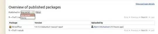

I don't know of any software to do that, but from the PPA's webpage it is easy to check, by deploying the list in section "Overview of published packages" (see the image below).
published packages
Click to see a higher-resolution image.
If you use really a lot of PPAs, this can get tiring.
Perhaps an internet crawling script might help? With that I couldn't help you much, though.
Image taken from this Q&A in ask.libreoffice.org.
