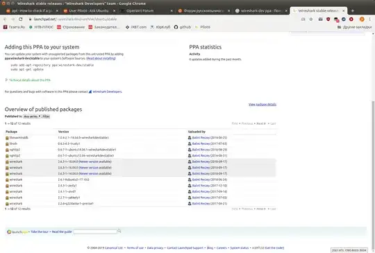

You can alsways check it on PPA Web page.
E.g for wireshark-dev PPA you can check
https://launchpad.net/~wireshark-dev/+archive/ubuntu/stable
There you can see what is available. You can also filter by Ubuntu release.
As you can see, there is nothing for disco if you click "Published in" drop down.
