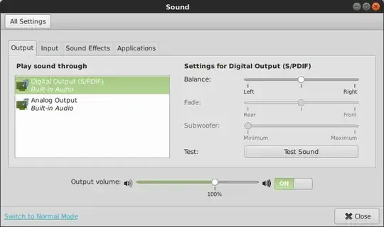

I'm trying to use the optical audio output of my motherboard to send the sound to my AV Receiver.
I only see the front channels received by my AV.
Indeed rear channels don't seem to be activated.
How can I activate the rear channels ?
