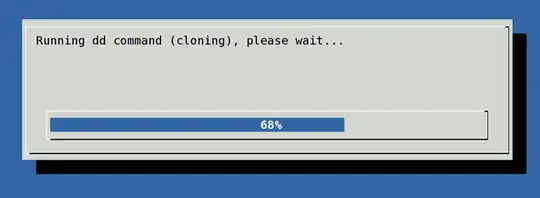

There are several solutions available via google search.
From http://www.cyberciti.biz/faq/linux-unix-dd-command-show-progress-while-coping/
(pv -n /dev/sda | dd of=/dev/sdb bs=128M conv=notrunc,noerror) 2>&1 | dialog --gauge "Running dd command (cloning), please wait..." 10 70 0
You may have to install dialog and pv
sudo apt-get install pv dialog
