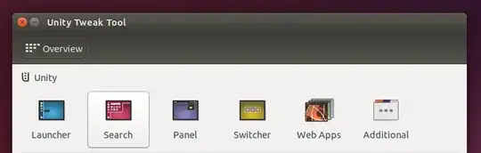

Additionally you can install
sudo apt-get install unity-tweak-tool
and disable the seach there:
enter image description here 6. Uncheck Search online sources and Show "More Suggestions"
source: https://fixubuntu.com/
