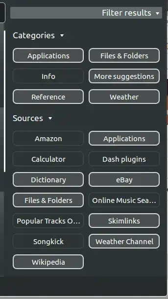

But in the actual dash, I still have a lot of crud:
I had also made sure that system settings > Security & Privacy > Search > Include online search results is off. Next time I checked, it was on again. I turned it off again. Now after yet another reboot it seems to stay off (but I no longer trust it to stay there).
With that privacy setting off, the dash no longer shows me the results, but the filters are still available and I want them completely gone. (I don't ever need weather in my dash and I don't even know what "Skimlinks" is.)
--> How do I get rid of this?! Thank you very much in advance!
You can remove some scopes thru a package manager, synaptic works well.
The other way for any unwanted that remain is to open the Applications lens. Scroll down to Dash plugins, click on the 1st one listed. If wanted click on > to move to next plugin. If not wanted then click on disable, then > twice to go to the next scope. Repeat as desired to move thru all the scopes disabling ones you don't want.
A log in/out may be required to reflect changes.
