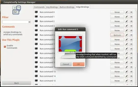

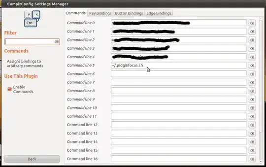

5) Open Compiz (Menu > System > Preferences > CompizConfig Manager)
6) Go to Commands and add ~/.pidginfocus.sh to one command
7) And use Edge Binding (Botton) to run it.

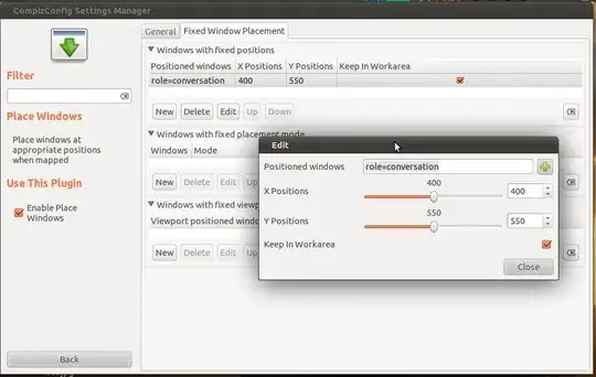

8) Now go to Compiz > Enable Place Windows and set the role conversation to be opened at botton:
You may need to adjust the numbers according with your screen resolution.
