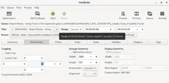

Another open-source GUI tool, that can split videos, and do much more, is handbrake
For example, here I'm splitting my video on 24.53 (mm:ss), and also cropping the frame on the right side: enter image description here
You can see the preview of the output easily - with the "Preview" button.
