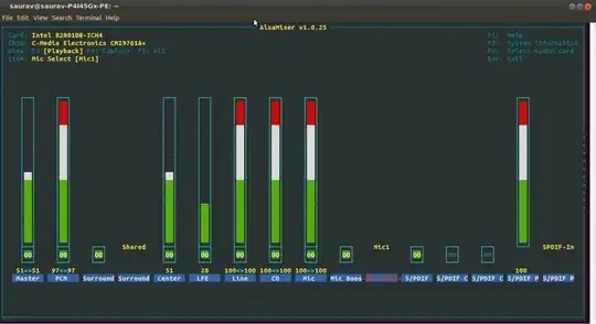

I've found a way which will surely solve your problem of low sound in headphone.
  • First play any song so that you can feel the change in sound.
  • Run this command in terminal:
    alsamixer
    if alsamixer is not installed then install it by: sudo apt-get install gnome-alsamixer
  • In terminal itself one interface will be opened as shown here:
(source: akamaihd.net)
  • Now use your -> arrow key to reach to option mic select. It is shown in red colour for which it is displaying Mic1 as value. For you it would display Mic2
  • Change it to Mic1 by using Up or Down arrow keys.
  • Your headphone sound should be increased. If not then try to change (increase/decrease) other values by Up or Down arrow keys.
Hope it would work for you this time.. Reply if you need any further assistance..
