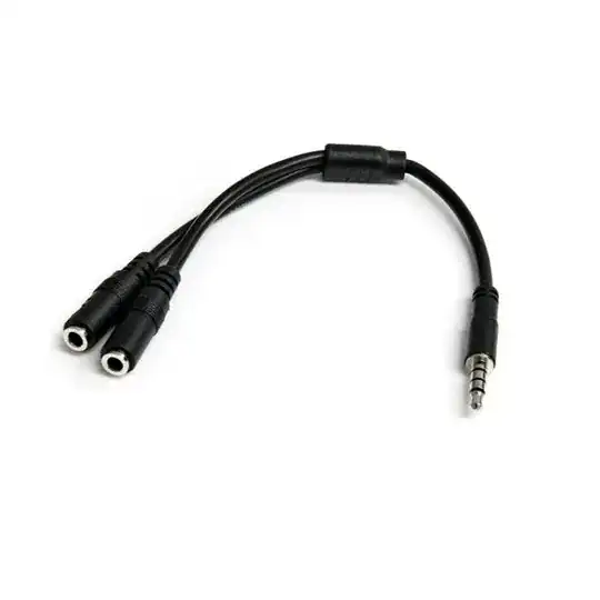

This the reason why I bought a spliter like below:
Splits one 4 pines jack into two jacks: micrphone and line out
I have an external studio microphone and headphones with the micrphone.

Would be the splitter an cause?

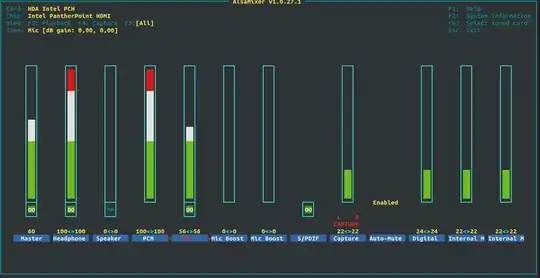

Update 2: Using alsamixer I managed to listen only the piano sounds, without other microphone sounds. This is how the current alsamixer configuration looks:
The information about my settings can be found here.
I still cannot select in Audacity (or other recording software) the recording device. It records from the internal microphone.

By increasing that mic volume meter in alsamixer we only turn on the soundcards loopback feature, that is it redirects the mic input to the sound output internally, this stream is not accessible for softwares. (AFAIK) (But it confirms that the hardware receives the sound.)
You should try to increase all Capture meters in alsamixer to the maximum and make sure they are not muted, after this make sure that in pavucontrol the correct device and port is selected, and the mic input is not muted there, then try recording.
If it still not works, then it is likely that the problem is somewhere lower in the driver.
What you could still try is installing a newer alsa, maybe this problem is solved in a newer version. Other than that there are some tweaking tools for alsa here. Docs for it here. With the hda-jack-retask thing you are able to change your microphone input to a line-in one (or similar things), but I don't know whether that will help.
