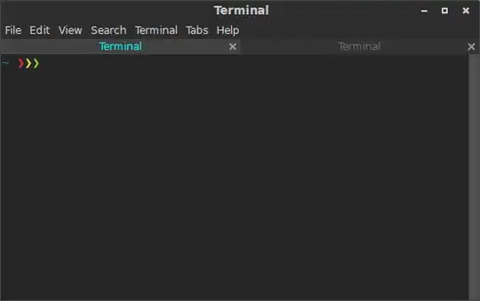

If you wish to make the text of the active tab more obvious you can modify it's label like this,
edit the file ~/.config/gtk-3.0/gtk.css
TerminalTabLabel.active-page .label {
    color: cyan;
    font-weight: bold;
Tested in gnome-terminal 3.17.91

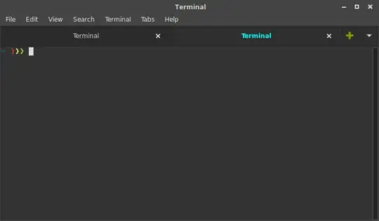

Here is what I'm using at work on Ubuntu 15.10 with gnome-terminal 3.16.2. The smaller tab size allows more screen area for the terminal to use and I've experimented with the contrast between active and inactive tabs. I think the tab label text looks better without the bold style applied.
/* gnome-terminal */
@define-color term-win-bg           #262626;
@define-color term-tab-inactive-bg  #333333;
@define-color term-tab-active-bg    #424242;
@define-color ubuntu-orange         #fb9267;
TerminalScreen {
    -TerminalScreen-background-darkness: 0.95;
    background-color: @term-win-bg;
TerminalWindow .notebook {
    border: 0;
    padding: 0;
TerminalWindow .notebook tab {
    border: 0;
    border-radius: 0px;
    border-image: -gtk-gradient (linear, left top, left bottom,
                                from (alpha (shade (@term-win-bg, 0.9), 0.0)),
                                to (shade (@term-win-bg, 0.9))) 1;
    border-image-width: 0 1px;
    border-color: transparent;
    border-width: 0;
    box-shadow: none;
    background-color: shade(@term-tab-inactive-bg, 1);
TerminalWindow .notebook tab:active {
    border: 0;
    border-radius: 0px;
    background-color: shade(@term-tab-active-bg, 1);
    /*color: @bg_color;
    font-weight: bold
    color: @ubuntu-orange; */
    color: cyan;

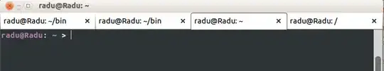

I don't have any problem to distinguish active and inactive tabs in gnome-terminal using the default Ubuntu theme - Ambiance.
Looking on Launchpad, I found that this is a confirmed bug affecting many people: Difficult to distinguish which tab is selected.
If this is affecting you also, you can solve this by changing your Ubuntu theme: right click on the desktop, select Change Desktop Background and in the new opened window change your theme to High Contrast:
change ubuntu theme
Then you can distinguish without problems your active and inactive tabs in gnome-terminal:
terminal tabs
