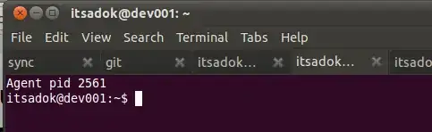

Something about the color scheme changed in 11.04, and now it's very difficult for me to tell which tab is the selected one.
On my screen, the colors look more similar the further down I slouch in my chair (i.e. angle of view).
If I change the color scheme the problem is solved, but that solution is too extreme for me. Is there a way to just change the color of the selected tab in terminal, or otherwise make it more prominent?
