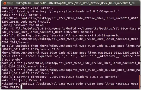

So I downloaded latest driver from Realtek website, copied to desktop, and extracted it. In terminal i run
sudo apt-get install gcc build-essential linux-headers-generic linux-headers-$(uname -r)
for necessary dependencies. I then enter
cd ~/Desktop/rtl_92ce_92se_92de_8723ae_88ee_linux_mac80211_0012.0207.2013
make
make install
Command Terminal read out.At this point I get a long scroll with a few mentions of error1 and error 2. I try to reboot the computer with
sudo modprobe -v rtl8188ee
but it says it cannot be found. So I manually reboot, and nothing changes under "Additional Drivers" scan. So I can't tell if I'm not installing correctly, or if there is something else going on.

Here's what I get after entering
make clean
in the terminal: Make clean prompt Ok. After following the steps in the answer provided by Chili555 below, I believe everything went smoothly. It's worth stating that after entering the
sudo modprobe rtl8192ce
command, nothing happened. So I rebooted manually. I now have all bars lit up in my wifi icon (as opposed to before, when I only had 3)
Chili555 put up a text file in the comment section below that shows what it should look like when entering the 4 lines of code in gedit. That was very helpful. Also, be mindful of where your directory is when entering a command in terminal for cleaning up download. I specified "desktop" because that's where my extracted zip was located.

First, let's clean up the file from your first attempt:
cd Desktop/rtl_92ce_92se_92de_8723ae_88ee_linux_mac80211_0012.0207.2013
make clean
Now, let's modify one file:
gedit pci.h
At the top of the file,after the comment section all out lined in **, add this sequence:
#ifndef __devinit
#define __devinit
#define __devinitdata
#endif
Proofread carefully, save and close gedit. Now do:
make
sudo make install
Finally, I believe the driver you need is rtl8192ce and not rtl8188ee:
Your wireless should now be working.
