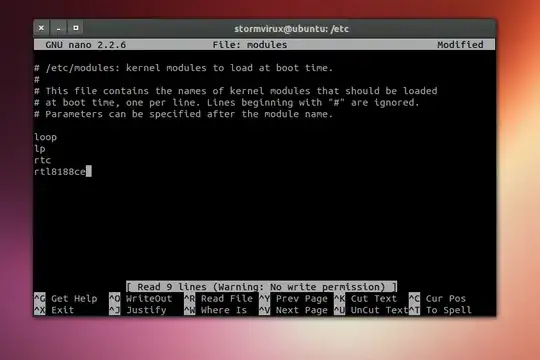

  8. Now If all went right your system should be running the wireless driver,Now we need to tell the system to load it whenever it starts, so we will edit the file /etc/modules
    sudo nano /etc/modules
The file initially will look like this
we add the line rtl8192ce to it and it will look like this
Press ctr+O to save it and ctr+X to exit nano editor
