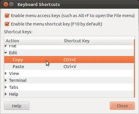

You can also change the system default keymappings - so you can ctrl+v into terminal.
Edit->Keyboard Shortcuts
