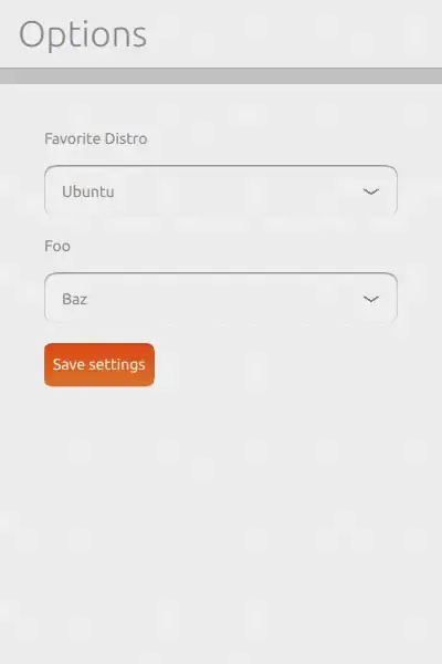

It sets up a database and some functions to get and save key/value pairs. Then it provides an interface using the Ubuntu OptionSelector components.
settings dialog
