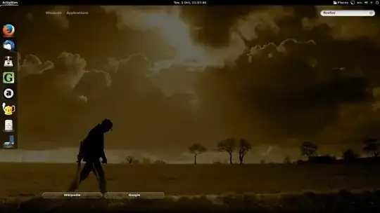

To clarify: When I say the search box doesn't work, I mean I type something in it and I see no search results.
desktop with no search
In the picture above, Firefox should have appeared, but it didn't. The same is true for the Advanced Calculator and the Firefox Bookmarks plugins which leads me to believe there's something wrong with core Gnome shell, and not the plugins themselves.
