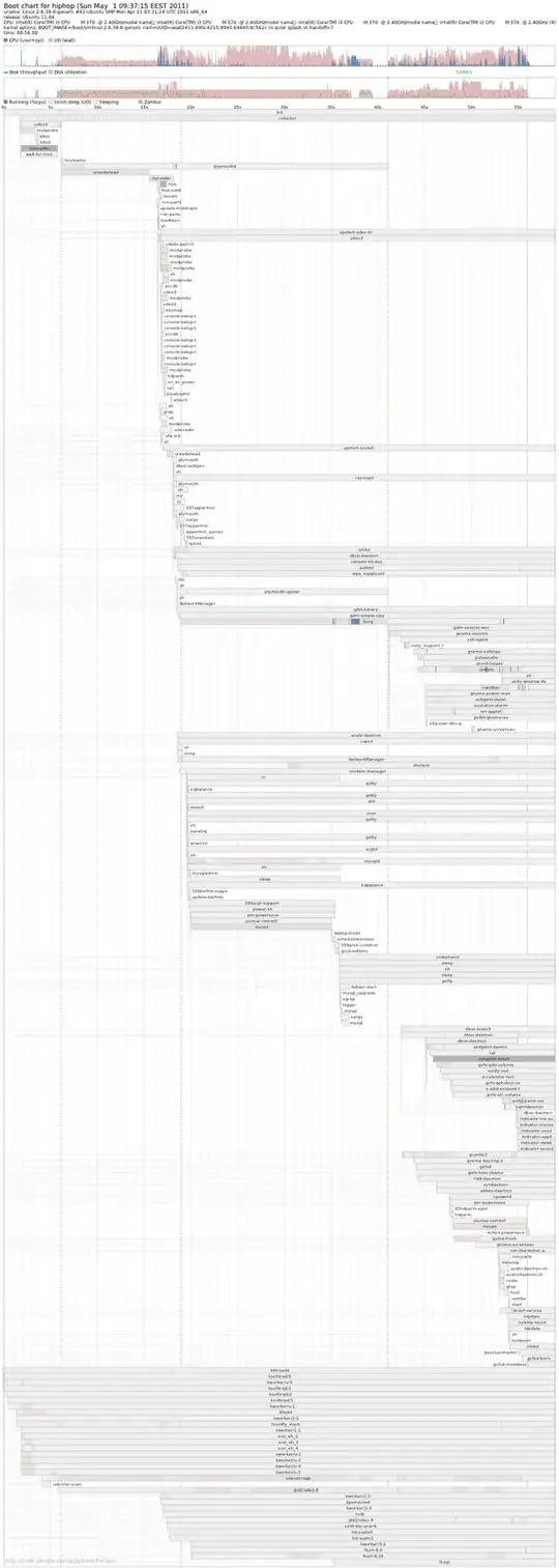

Well, I have an Ubuntu 12.04 running on a Core i7 laptop, with an SSD disk. The laptop is a dual-boot. I experience a very large delay between the password entry and the Desktop showing up. In general, the process looks like this:
  • Grub loads fast.
  • I choose Ubuntu from the list.
  • Password prompt loads fast.
  • I enter the password for my user. The computer kinda hangs. The Wifi is flashing, but the hard drive light is not flashing a lot. This takes about 30-40 seconds.
  • The Desktop loads in a flash
I've experienced this issue in the past, with my standard HDD. Then I removed UbuntuOne as advised in a thread that I've seen. This seems to have helped for a while. Then I migrated to the SSD. The computer loaded pretty fast for a while, then this started happening. I don't think that it is related to the SSD, though.
I'm adding a link to a bootchart image:
https://i.sstatic.net/2oyXf.png
While I was troubleshooting this, I noticed that my username shows up as [Invalid UTF-8] in the top right corner of the screen. These are the cases when the Desktop loads with a delay.
Sometimes, the desktop manages to load fast. In this case the username is shown normally.
The [Invalid UTF-8] seems to be a known bug, but I was not able to find a working solution.
Thank you for your time.
I ended up completely reinstalling the OS. This solved the problem.

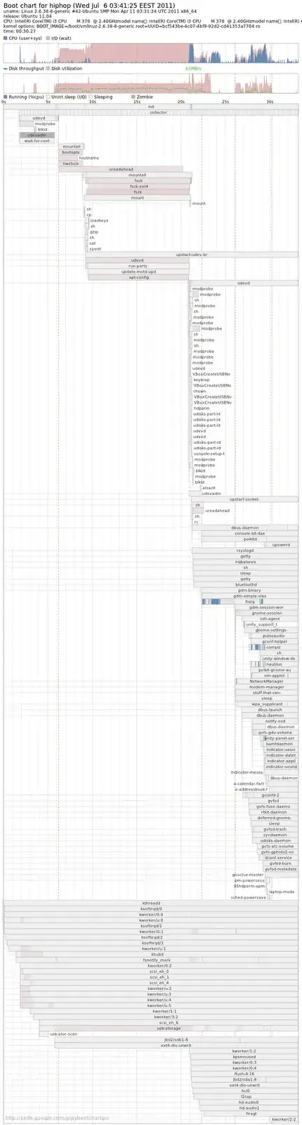

Here is a Blog by "George Georgovassilis" that has some more insight into reading the boot chart and how to speed things up...
Measuring progress
Bootchart is a nice package that protocols meticulously the entire boot process and creates graphical charts of the times and where they are spent. So the first step is getting bootchart:
sudo apt-get install bootchart
After rebooting, you can get aforementioned chart in /var/log/bootchart. A word of caution: the first chart is non-representative, as ureadahead is in profiling mode and slows things down. After another reboot the chart would look much better. And that is how it looks like:
The chart shows three milestones: the X-Window manager starts at 19 seconds after boot, Gnome at 41seconds and the desktop is visible at 59 seconds, which I'll consider also the entire time of the boot. That's the time to beat.

After rebooting, the chart looks like this:
Much better, ureadahead runs now in parallel. Unfortunately it made the boot process 1 sec slower, mainly delaying X and Gnome. But I feel I am on to something, so let's not just give up.

Which leaves us with 28sec boot time:
Copied and Edited from here → http://georgovassilis.blogspot.com/2011/05/speeding-up-ubuntu-1104-boot-time.html
