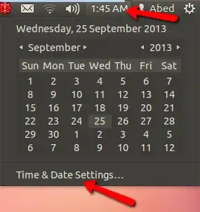

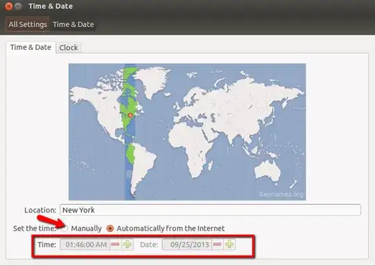

In 12.04 I don't have to Unlock anything. Just click on the clock on the top bar, and choose Time & Date Settings, once the Time & Date window opens, choose Manually, so you can change the time and date manually; otherwise choose your time zone from the map, and choose Automatic.
