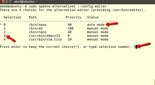

Try this. Just press Ctrl+Alt+T on your keyboard to open Terminal. When it opens, run the command(s) below:
sudo update-alternatives --config editor
When it comes up choose your editor. See image below.
