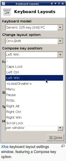

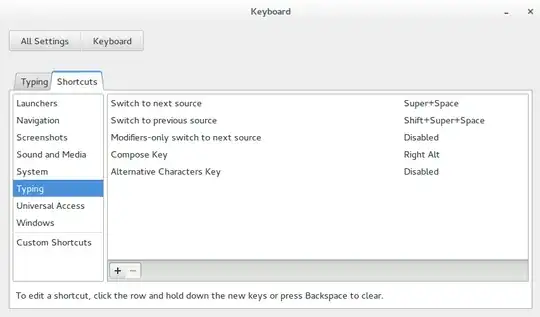

Open your keyboard settings (system settings → keyboard settings) and go to the shortcuts tab. Under the "typing" section you'll find a "Compose Key" setting. Set this to your compose key (I advice right alt to keep your know shortcuts)
Gnome Compose Key setting for gnome
Unity Compose Key setting for Unity Xfce
Compose Key setting for xfce. Source: wikipedia Compose Key

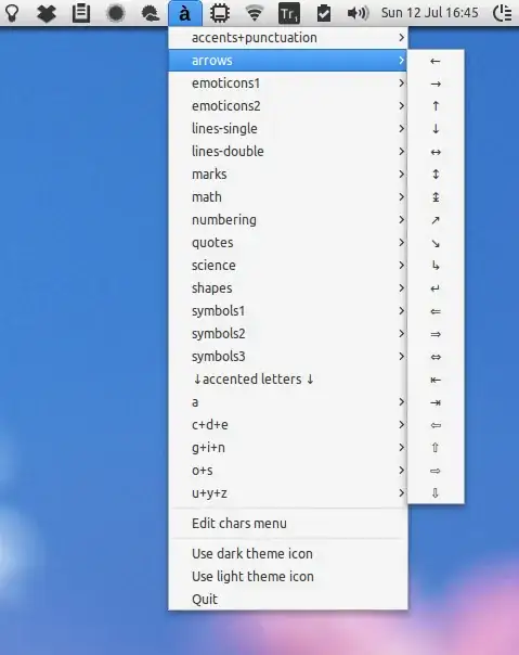

A GUI Alternative: indicator-chars
Installing this small indicator will let you easily insert characters like this without having to memorize many key combinations:
https://github.com/Sadi58/indicator-chars
