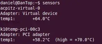

Displaying sensor data
Now, to show the temperatures, type:
sensors
Now you should see something like that:
My sensors result
I don't have many sensors, btw :)

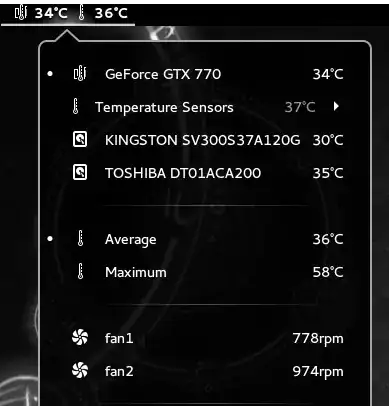

I have recently found a cool extension for Gnome 3. So if you are using it - you can install this and see the temperature in the tray:
https://extensions.gnome.org/extension/541/nvidia-gpu-temperature-indicator/

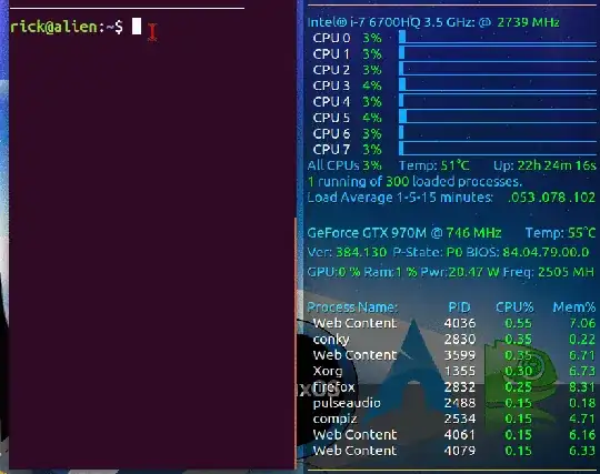

GPU Temperature with Conky
Conky is a light weight (on resources, not features) system monitor popular in Linux. You can use it to constantly display GPU temperature along with other system elements you like to follow.

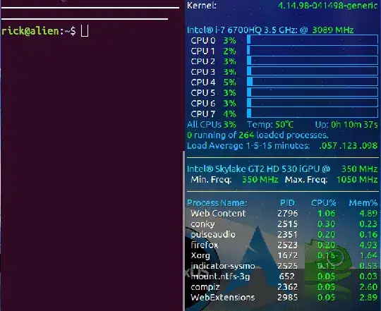

Most laptops with nVidia GPUs also include an Intel Integrated GPU (iGPU) for use when on battery power.
My Conky display changes depending on whether Intel or nVidia is selected.
Below are GIFs for nVidia and Intel before and running glxgears to tax the GPU. I'll try to find a more demanding graphics test than glxgears in the future.
Display for Laptop with NVIDIA active
Here's what my Conky looks like when prime-select nvidia is active:
gpu temp nvidia
Initially there is low load on nVidia GPU and it's running at 746 MHz and is 55 degrees Celsius. After running glxgears GPU speed spikes to max speed of 1037 MHz and temperature climbs to 58 degrees Celsius.
Display for Laptop with Intel Integrated GPU active
Here's what my Conky looks like when prime-select intel is active:
intel GPU
Initially there is low load on Intel Integrated GPU (iGPU) and temperature (of CPU) is 49 degrees Celsius. After running glxgears CPU temperature climbs to 73 degrees Celsius!
Conky code
Here is the relevant conky code for above:
# Temperature|
#${color1}All CPUs ${color green}${cpu}% ${goto 131}${color1}Temp: ${color green}${execpi .001 cat /sys/class/thermal/thermal_zone7/temp | cut -c1-2}°C ${alignr}${color1}Up: ${color green}$uptime
# Next line is for kernel >= 4.13.0-36-generic
${color1}All CPUs ${color green}${cpu}% ${goto 131}${color1}Temp: ${color green}${hwmon 1 temp 1}°C ${alignr}${color1}Up: ${color green}$uptime
# Next line is for temperature with Kerenel 4.4
#${color1}All CPUs ${color green}${cpu}% ${goto 131}${color1}Temp: ${color green}${hwmon 0 temp 1}°C ${alignr}${color1}Up: ${color green}$uptime
${color green}$running_processes ${color1}running of ${color green}$processes ${color1}loaded processes.
${color1}Load Average 1-5-15 minutes: ${alignr}${color green}${execpi .001 (awk '{printf "%s/", $1}' /proc/loadavg; grep -c processor /proc/cpuinfo;) | bc -l | cut -c1-4} ${execpi .001 (awk '{printf "%s/", $2}' /proc/loadavg; grep -c processor /proc/cpuinfo;) | bc -l | cut -c1-4} ${execpi .001 (awk '{printf "%s/", $3}' /proc/loadavg; grep -c processor /proc/cpuinfo;) | bc -l | cut -c1-4}
# Intel iGPU |
${color orange}${hr 1}${if_match "intel" == "${execpi 99999 prime-select query}"}
${color2}${voffset 5}Intel® Skylake GT2 HD 530 iGPU @${alignr}${color green}${execpi .001 (cat /sys/class/drm/card1/gt_cur_freq_mhz)} MHz
${color}${goto 13}Min. Freq:${goto 120}${color green}${execpi .001 (cat /sys/class/drm/card1/gt_min_freq_mhz)} MHz${color}${goto 210}Max. Freq:${alignr}${color green}${execpi .001 (cat /sys/class/drm/card1/gt_max_freq_mhz)} MHz
${color orange}${hr 1}${else}
# Nvidia GPU |
${color2}${voffset 5}${execpi .001 (nvidia-smi --query-gpu=gpu_name --format=csv,noheader)} ${color1}@ ${color green}${execpi .001 (nvidia-smi --query-gpu=clocks.sm --format=csv,noheader)} ${alignr}${color1}Temp: ${color green}${execpi .001 (nvidia-smi --query-gpu=temperature.gpu --format=csv,noheader)}°C
${color1}${voffset 5}Ver: ${color green}${execpi .001 (nvidia-smi --query-gpu=driver_version --format=csv,noheader)} ${color1} P-State: ${color green}${execpi .001 (nvidia-smi --query-gpu=pstate --format=csv,noheader)} ${alignr}${color1}BIOS: ${color green}${execpi .001 (nvidia-smi --query-gpu=vbios_version --format=csv,noheader)}
${color1}${voffset 5}GPU:${color green}${execpi .001 (nvidia-smi --query-gpu=utilization.gpu --format=csv,noheader)} ${color1}Ram:${color green}${execpi .001 (nvidia-smi --query-gpu=utilization.memory --format=csv,noheader)} ${color1}Pwr:${color green}${execpi .001 (nvidia-smi --query-gpu=power.draw --format=csv,noheader)} ${alignr}${color1}Freq: ${color green}${execpi .001 (nvidia-smi --query-gpu=clocks.mem --format=csv,noheader)}
${color orange}${hr 1}${endif}

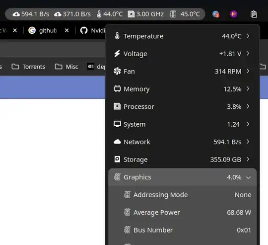

For anybody in the year 2024 an above. There are 2 excellent tools in Gnome, for this.
Vitals - https://extensions.gnome.org/extension/1460/vitals/
This one has an option to show the Video card Temperature and other factors as well. It is the one I use. Here is a screenshot:
Freon - https://extensions.gnome.org/extension/841/freon/
This is another one that also offers similar features.

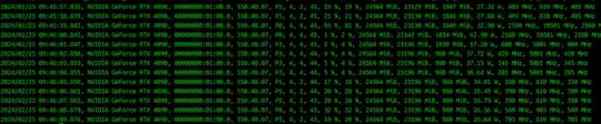

For Console cases, you could use nvidia-smi for Nvidia cards for example like this
nvidia-smi --query-gpu=timestamp,name,pci.bus_id,driver_version,pstate,pcie.link.gen.max,pcie.link.gen.current,temperature.gpu,utilization.gpu,utilization.memory,memory.total,memory.free,memory.used,power.draw,clocks.sm,clocks.mem,clocks.gr --format=csv -l 1
Which would return a very thorough and detailed analysis of the Nvidia card
2024/02/25 09:45:57.835, NVIDIA GeForce RTX 4090, 00000000:01:00.0, 550.40.07, P5, 4, 2, 45, 19 %, 19 %, 24564 MiB, 23129 MiB, 1047 MiB, 27.32 W, 405 MHz, 810 MHz, 405 MHz
2024/02/25 09:45:58.839, NVIDIA GeForce RTX 4090, 00000000:01:00.0, 550.40.07, P5, 4, 2, 45, 21 %, 21 %, 24564 MiB, 23130 MiB, 1046 MiB, 27.88 W, 405 MHz, 810 MHz, 405 MHz
2024/02/25 09:45:59.842, NVIDIA GeForce RTX 4090, 00000000:01:00.0, 550.40.07, P0, 4, 4, 45, 95 %, 81 %, 24564 MiB, 23130 MiB, 1046 MiB, 32.90 W, 2580 MHz, 10501 MHz, 2580 MHz
2024/02/25 09:46:00.845, NVIDIA GeForce RTX 4090, 00000000:01:00.0, 550.40.07, P0, 4, 4, 45, 1 %, 2 %, 24564 MiB, 23142 MiB, 1034 MiB, 62.90 W, 2580 MHz, 10501 MHz, 2580 MHz
2024/02/25 09:46:01.847, NVIDIA GeForce RTX 4090, 00000000:01:00.0, 550.40.07, P3, 4, 4, 45, 2 %, 4 %, 24564 MiB, 23146 MiB, 1030 MiB, 57.20 W, 600 MHz, 5001 MHz, 600 MHz
2024/02/25 09:46:02.850, NVIDIA GeForce RTX 4090, 00000000:01:00.0, 550.40.07, P3, 4, 4, 44, 4 %, 4 %, 24564 MiB, 23196 MiB, 980 MiB, 37.72 W, 420 MHz, 5001 MHz, 420 MHz
2024/02/25 09:46:03.853, NVIDIA GeForce RTX 4090, 00000000:01:00.0, 550.40.07, P3, 4, 4, 44, 5 %, 4 %, 24564 MiB, 23196 MiB, 980 MiB, 37.15 W, 345 MHz, 5001 MHz, 345 MHz
2024/02/25 09:46:04.855, NVIDIA GeForce RTX 4090, 00000000:01:00.0, 550.40.07, P3, 4, 4, 44, 5 %, 4 %, 24564 MiB, 23196 MiB, 980 MiB, 36.64 W, 285 MHz, 5001 MHz, 285 MHz
2024/02/25 09:46:05.858, NVIDIA GeForce RTX 4090, 00000000:01:00.0, 550.40.07, P5, 4, 2, 44, 17 %, 18 %, 24564 MiB, 23196 MiB, 980 MiB, 34.01 W, 330 MHz, 810 MHz, 330 MHz
2024/02/25 09:46:06.861, NVIDIA GeForce RTX 4090, 00000000:01:00.0, 550.40.07, P5, 4, 2, 44, 20 %, 20 %, 24564 MiB, 23196 MiB, 980 MiB, 26.49 W, 390 MHz, 810 MHz, 390 MHz
2024/02/25 09:46:07.865, NVIDIA GeForce RTX 4090, 00000000:01:00.0, 550.40.07, P5, 4, 2, 43, 20 %, 20 %, 24564 MiB, 23196 MiB, 980 MiB, 26.79 W, 390 MHz, 810 MHz, 390 MHz
2024/02/25 09:46:08.870, NVIDIA GeForce RTX 4090, 00000000:01:00.0, 550.40.07, P8, 4, 1, 43, 32 %, 32 %, 24564 MiB, 23196 MiB, 980 MiB, 26.56 W, 540 MHz, 405 MHz, 540 MHz
2024/02/25 09:46:09.876, NVIDIA GeForce RTX 4090, 00000000:01:00.0, 550.40.07, P5, 4, 2, 43, 19 %, 20 %, 24564 MiB, 23196 MiB, 980 MiB, 26.64 W, 705 MHz, 810 MHz, 705 MHz
