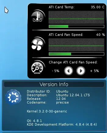

Description: This widget will display current ATI screen card fan speed and temperature. It will also allow the modification of the fan speed in 5% increments.
At here
Downloading the widget - unpacking it - starting the Karamba: Alt+F2 karamba. Adding the local theme...
Seems to work at here.
