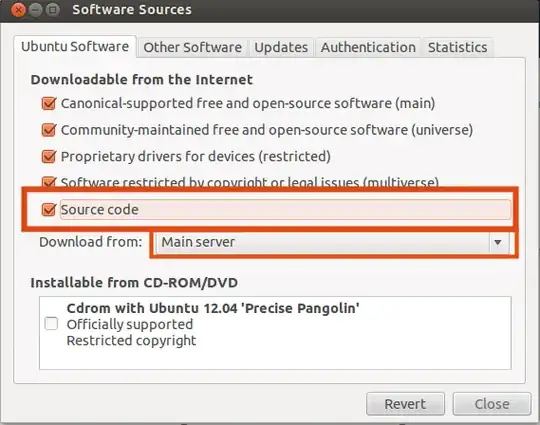

Make sure you have enable the "Source code repository"
In the Menu Bar choose Edit -> Software Sources. Click to enable "Source code repository". Just in case I use the "Main Server" to Download.
Then..

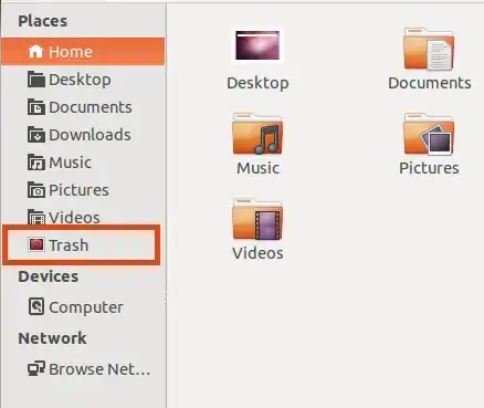

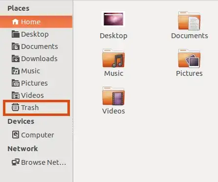

4) Trash-Full icon in nautilus-places.
Nautilus 3.6.3 use the following icon for the trash-full (user-trash-full-symbolic.svg), not present by default in Ubuntu 12.04.
You can grab the icon from Ubuntu 13.04 to put it in /usr/share/icons/gnome/scalable/status/ directory.
To avoid this:
Once you have the correct icon type in the Terminal.
  • sudo mv /path/to/trash/image/user-trash-full-symbolic.svg /usr/share/icons/gnome/scalable/status/
  • sudo chmod 644 /usr/share/icons/gnome/scalable/status/user-trash-full-symbolic.svg
  • sudo gtk-update-icon-cache /usr/share/icons/gnome/

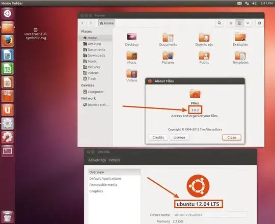

Result:
Hope this helps.
