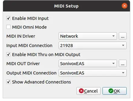

vmpk produces sound by default on Ubuntu 20.04
I don't fully understand the details, but on Ubuntu 20.04 I just get sound out of the box from vmpk (not using Qsynth and JACK).
Likely the relevant settings which make it work by default are:
  • Edit
  • MIDI Connections
  • MIDI OUT Driver: Sonivox EAS
Working with ALSA
If you want to pipe ALSA output to another synthesizer of your choice, in the MIDI Setup you can set instead:
  • MIDI OUT Driver: ALSA
