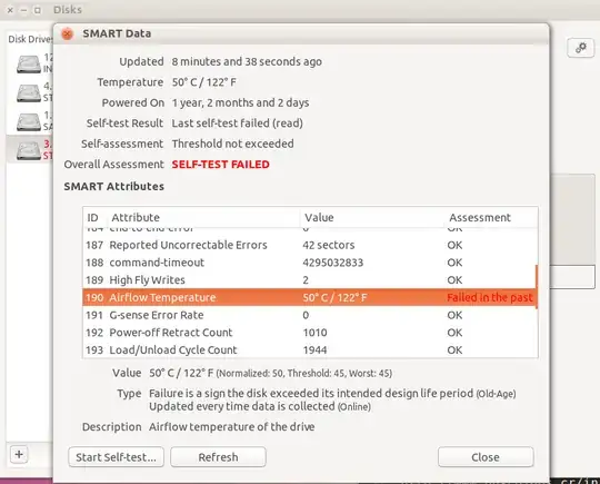

How can I reset the SMART results so it does not register previous results. My reason is that I was testing the hard drives closed together on a closed case. This made one of the HDD fail the Airflow Temperature reading.
After opening the case up (Which lowered the Temp of all drives 10 degrees Celsius in 5 minutes) and then separating the drives a bit more (3 less degrees) All results were good but since the Airflow reading failed in a previous reading, it always shows as failing.
So how can I reset the readings for SMART?

The point of current / worst attributes like temperature is exactly this: to tell you if the drive has ever been outside its max operating temperature, and thus might have suffered permanent damage.
That's why it says "failed in the past", not "failing now": you did just barely touch the max-temp threshold. Note the attribute display shows "normalized: 50, threshold: 45, worst: 45". (These are 0..200 normalized values like for any other attribute, not raw Celsius temps.)
You also have some bad sectors (uncorrectable sector errors), so whether the brief high temperature caused that or not, it's probably time to ditch that drive.

The software you're using looks like it's only showing the current temp, which is slightly below the threshold, but it's not going to hide the fact that the drive was out-of-spec at some point in the past.
You could certainly justify ignoring that momentary high-temperature, if you really did correct it in minutes. But you won't (or shouldn't) ever be able to make the drive itself lie about the fact that it was over its rated max temp for some time, and thus the attribute did fail in the past.

The thinking is that an overheat increases your chances for failure. SMART isn't saying your drive is bad, but has an increased chance for failure in the future.
SMART is meant to be an audit of the drives history and is maintained by the drive itself, so you cannot "reset" or "clear" SMART values.
