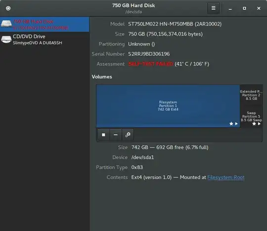

Having trouble to boot as bios and format my hard as MBR ( even GPT is not working ) here is a screenshot for further details
and when I ran smartctl -a /dev/sda I get the following output

I also get the same error as in this question on boot up
can someone help? can't find any solution anywhere

The HDD was failing as said in the above comments
