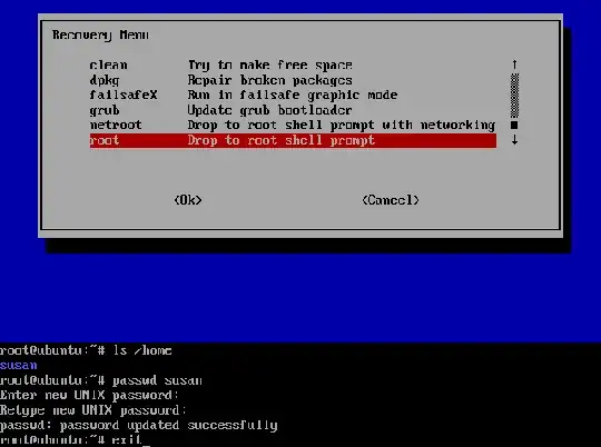

To repair that problem, try:
  1. Start Ubuntu in recovery mode - hold SHIFT key before the system boots, and it will display Grub bootloader. Select the last version of the kernel with the [recovery] in the end of the name. grub menu
  2. Select the root shell option recovery mode
  3. Try to upgrade your system - if there are problems (& errors), post them here... The other way, to select dpkg option - that may fix some other problems.
  4. Reboot - type exit to jump back to recovery menu, then there select resume boot option.
