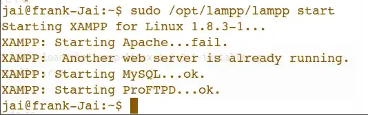

try this
sudo service mysql stop
sudo /opt/lampp/lampp restart
