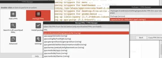

Then you can use Y-PPA manager. Open your terminal and type:
sudo add-apt-repository ppa:webupd8team/y-ppa-manager
sudo apt-get update
sudo apt-get install y-ppa-manager
Then open your Unity dash and search with Y -PPA and then open the Icon.
Click at manage PPAs as shown in the image and then select one PPA and it will give you the details of the PPA and Its packages.
