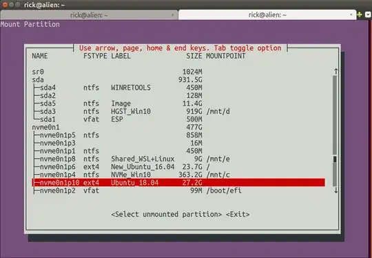

Script to mount drive - mount-menu.sh
The mount-menu.sh script allows you to select unmounted drives/partitions for mounting. To call the script use: sudo mount-menu.sh. This screen appears tailored to your unique machine environment:
  • Use arrow keys to select the partition and press Enter
The menu clears and leaves this information in your terminal:

done # Loop while errors.
Unmount partition
echo "" echo "=====================================================================" umount "$MountName" -l # Unmount the clone rm -d "$MountName" # Remove clone directory
echo $(tput bold) # Set to bold text echo $MountDev mounted on $MountName unmounted. echo $(tput sgr0) # Reset to normal text
CleanUp # Remove temporary files
exit 0
