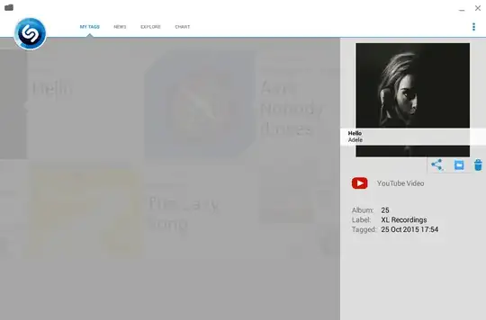

You can use Shazam for android with Archon Runtime and Google Chrome
http://archon-runtime.github.io/
  1. Download and install Shazam to your android device
  2. Export Shazam apk with Archon packager (install from google play) https://play.google.com/store/apps/details?id=me.bpear.archonpackager&hl=de
  3. Download Archon Runtime 2.1 Beta and Google Chrome Browser
  4. Enable Developer mode in Google chrome browser
  5. Extract Archon and downloaded Apk.zip
  6. Load Archon and Shazam as unpacked extension
  7. search the Shazam in the Dash and run the application
