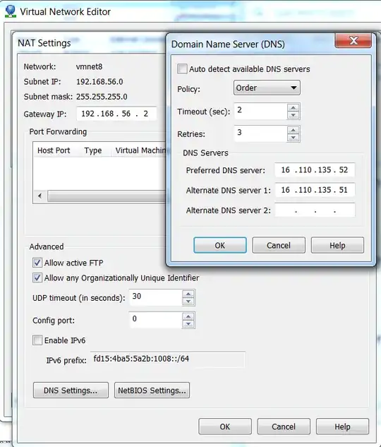

The gateway in your route table is set to the IP address of the host's VMNet8 interface whereas it should be set to the gateway address of the NAT interface. If you run the Virtual Network Editor and look at the NAT settings for the VMnet8 interface, you should find the gateway IP. Try setting the gateway to that address in the virtual machine.
Hope that helps.

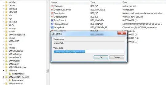

I have the alike issue. Finally, I checked the Win7 service and application. Find VMWare DHCP Service and NAP service is not running and start with fail. I checked the Registry, finding the two key value wrong, I edit these values with correct values set the NAT DNS with host's DNS. Then the host can communicate with VM each other. And VM can access the Internet.
