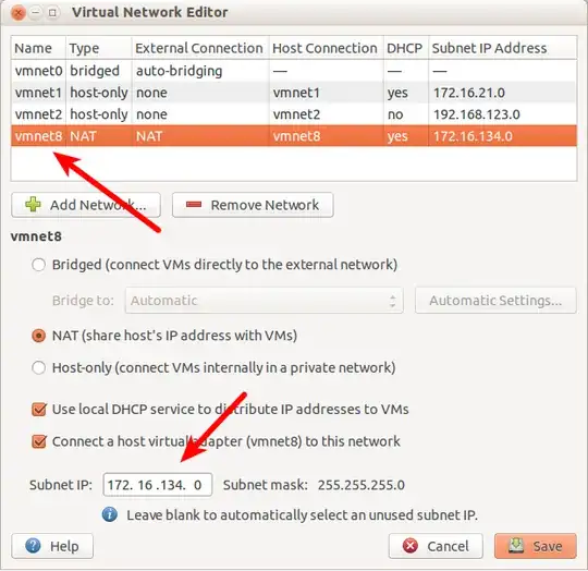

  1. Configure your (Windows) host machine to "obtain IP address automatically" on the VMnet8 adapter. It should get the IP 192.168.186.1.
  2. Configure your (Ubuntu) guest machine to a static IP in the range 192.168.186.3 - 192.168.186.127. Let's use 192.168.186.3. Also, configure the default gateway and dns server to be 192.168.186.2 So your /etc/network/interfaces should be:

If you want to use IPs from an altogether different network/pool other than 192.168.186.0/24, you'll need to go to Edit > Virtual Network Editor in VMware, find VMnet8, and change its DHCP settings at the very bottom to whatever network you want, and change the static IPs accordingly (the default gateway will always be the second usable IP, x.x.x.2).
