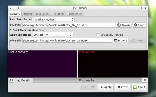

  3. Point Pyglossary to your file and set the input and output formats as follows:
    Input: tabfile, output: stardict
  4. Click apply. WARNING: Depending on the length of the word list conversion might be very memory-intensive.
  5. Import the dictionary to GoldenDict. This as well may use a lot of system memory (building the index, etc.)
Formatting should be acceptable (not perfect but usable). For further formatting tweaks (e.g. to remove annoying gender denominations) you would have to manually edit the input file.
