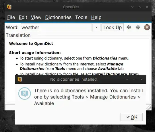

I have also installed Opendict but it asks to add dictionaries. How to do it? enter image description here

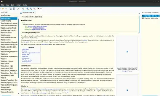

Many users recommend Goldendict, which comes with Wikipedia and to which I could add an English dictionary, enter image description here

You can use the "WordNet 3" dictionary which is supported by GoldenDict. To install it: Extract the Zip file and put it somewhere in your system then do the following: Edit>Dictionaries>Add>Then select the extracted folder and click "Apply".
You can download WordNet 3 from this link: http://en.sourceforge.jp/projects/sfnet_goldendict/downloads/dictionaries/WordNet3.0_1.0.zip/
