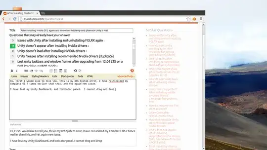

First i would like to tell you, this is my 8th System error, I have reinstalled my Complete OS 7 times earlier than this, and Yet again new issue.
I have lost my Unity Dashboard, and Indicator panel. I cannot drag and Drop and do nothing apart from running application via Terminal.
I can call them via terminal, but cannot use GUI options.enter image description here
Attached is Screenshot, you can see, it has no Indicator panel and no Unity menu.
