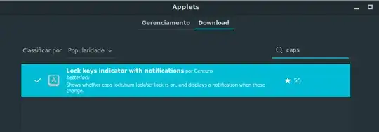

  • By right-clicking on the taskbar, select the "Applets" option Applets
  • Download > Search for: caps Lock keys indicator with notifications
  • Once installed, click 'Configure' and activate the desired notifications.
