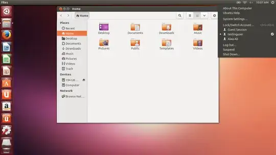

I then logged out of my account, and logged back in with testinguser, and here are the subdirectories automatically created:
alaa@aa-lu:~$ ls -l /home/testinguser/
total 36
drwxr-xr-x 2 testinguser testinguser 4096 Aug 23 10:05 Desktop
drwxr-xr-x 2 testinguser testinguser 4096 Aug 23 10:05 Documents
drwxr-xr-x 2 testinguser testinguser 4096 Aug 23 10:05 Downloads
drwxr-xr-x 2 testinguser testinguser 4096 Aug 23 10:05 Music
drwxr-xr-x 2 testinguser testinguser 4096 Aug 23 10:07 Pictures
drwxr-xr-x 2 testinguser testinguser 4096 Aug 23 10:05 Public
drwxr-xr-x 2 testinguser testinguser 4096 Aug 23 10:05 Templates
drwxr-xr-x 2 testinguser testinguser 4096 Aug 23 10:05 Videos
I didn't need to copy the contents of /etc/skel.
