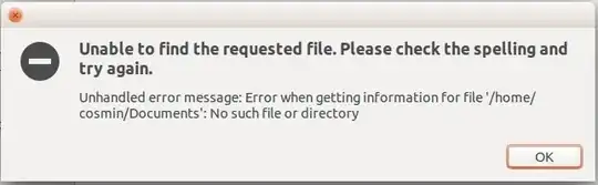

I have upgraded from Ubuntu 13.10 to 14.04 and now I can't access Documents, Music, Pictures and Videos folders.
When I click on them I get this message:
Did I choose to delete them during the installation or what I have done wrong and how can I fix this?

First, you may want to use the shell terminal in order to try to access your folders, so you can confirm if they exist or not, and, if they exist, see if they're empty or not. To do so, open a shell terminal window and run this supercommand:
cd ~ && ls -las --color |more
You'll see a colorful list of all the contents of your home folder (/home/cosmin). Even hidden files and folders will be shown to you. Press the spacebar key to scroll 1 page down and see more of the contents of your home directory. Repeat the process until the end. This will allow you to check if your personal directories - like Downloads, Documents et cetera - are still there. If they are, you can cd into them and check their contents. For instance, if the Downloads folder is present inside of your home folder, then this supercommand:
cd ~/Downloads && ls -las --color |more
...will show you what's inside of that folder.
If your folders are not present, then they were deleted. I'm sorry, they're gone, you'll have to recreate them. Please read this post about how to create new user accounts, manually create user folders et cetera.
If your folders are present, then close your file manager and run this command in the shell terminal:
xdg-user-dirs-update
Now try to access your folder again. If it didn't work, run this other command:
xdg-user-dirs-update --set DOCUMENTS $HOME/Documents
If it works, just repeat the process with your other directories:
xdg-user-dirs-update --set DOWNLOAD $HOME/Downloads
xdg-user-dirs-update --set MUSIC $HOME/Music
xdg-user-dirs-update --set PICTURES $HOME/Pictures
xdg-user-dirs-update --set VIDEOS $HOME/Videos
...and so on.
For more info, run this shell command:
info xdg-user-dirs-update
If xdg-user-dirs-update doesn't solve the problem, you may want to try something more extreme, like the following supercommand:
sudo rm -rfv ~/.cache ~/.config ~/.local ~/.profile && sudo telinit 6
The supercommand above will delete your profile's cache, GUI configuration files, profile data and preferences, then restart the system. Afterwards, you may try running those xdg-user-dirs-update --set... commands again.
If nothing works but your personal folders (Downloads, Documents etc.) exist and are not empty, make a backup of them. E.g. if you plug in a flash drive mounted at /media/cosmin/BACKUP, then you can run this command:
sudo cp -R ~ /media/cosmin/BACKUP
...or you may prefer to copy folders one by one:
sudo cp -R ~/Downloads /media/cosmin/BACKUP
sudo cp -R ~/Documents /media/cosmin/BACKUP
sudo cp -R ~/Pictures /media/cosmin/BACKUP
...and so on.
After the backup, use the control panel in order to:
  • Create a new user account and give it administrative privileges (this is gonna be your new account).
  • Then delete the (now old) account "cosmin".
  • Copy the contents from your backup back to your personal folders. Note: do NOT overwrite the folders! E.g. if the new account is cosmin2, then instead of copying /media/cosmin/BACKUP/Downloads over /home/cosmin2/Downloads, you'll have to access /media/cosmin/BACKUP/Downloads and copy everything that's inside this folder, then paste them inside of /home/cosmin2/Downloads.
Yuri Sucupira
  • 1,024
  • 15
  • 28
Uh! Uprade seem to format previous /home
You could try to look if old root did hold something:
sudo mount --bind / /mnt
ls -l /mnt/home/cosmin
sudo umount /mnt
If ls command fail, there is nothing to found here.
Last thing to do, if your upgrade if fresh (recent format and few activities on /home)
  1. Comment /home if /etc/fstab:
    sed -re '/\s\/home\s/s/^/# /' -i /etc/fstab
  2. Prepare to run without /home but with minimal user dir in /
    sudo cp -a /etc/skel /mnt/home/cosmin
    sudo chown -R cosmin: /mnt/home/cosmin
  3. Reboot your system
  4. Install testdisk and try to restore your files...
    sudo aptitude install testdisk
    testdisk /dev/sda7
... Sorry, good luck!
