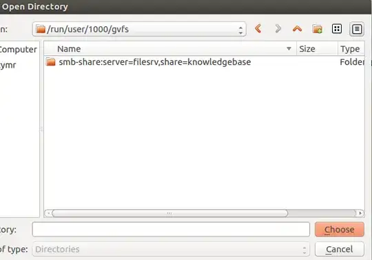

in ubuntu 16.04 and vlc 2.2.2 ;
Select media > Open Directory and navigate to /run/user/1000/gvfs/ << ID number (1000) can be vary on your system.
Here you can see the shared folder name and select the folder whichever you want to add in playlist (see picture below)
vlc add dierctory
