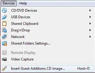

I know this is an old question and it's asking about doing the reverse (host is Linux, guest is Windows) but I hope this will help others like myself set up drag'n'drop where the host is Windows and guest is Linux.
In the VirtualBox window with the VM, click Devices > Insert Guest Additions CD image...
It will appear as a mounted CD in the Linux host OS. Follow the steps to install it, then reboot the VM.
Then enable Drag'n'Drop with Devices > Drag'n'Drop > Bidirectional
(you can also choose another option if you don't want bidirectional drag'n'drop)
You may also want to enable Shared Clipboards with Devices > Shared Clipboard > Bidirectional.
